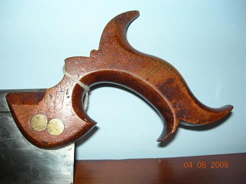

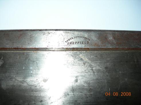

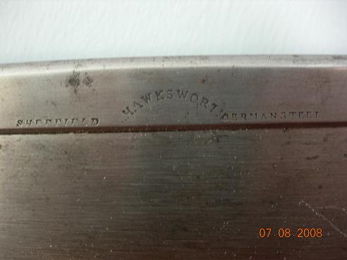

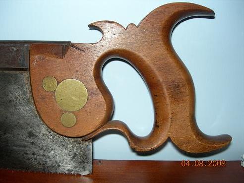

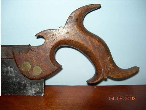

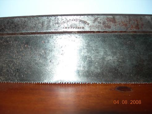

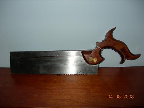

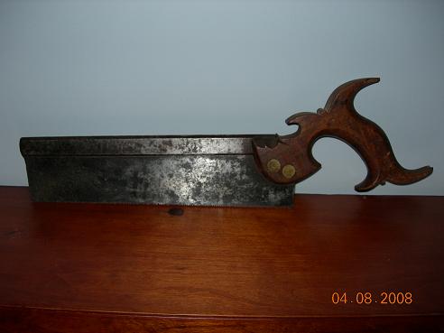

    It would seem there has been some new discussion on the use of the medallion in conjunction with the trade mark and the many variations of the Warranted Superior medallion that have appeared through the years. I am wondering if the large flat faceless medallions were created for those makers hadn\'t found a trade mark, didn\'t produce enough to justify making one for their product or really too early for the accepted style which became the norm? As an example I have included three saws by Thomas B Hawksworth who am assuming was from the partnership of Wilson, Hawksworth,Moss and maybe Ellison depending on the date of manufacture. Why only Thomas signed his saws is a mystery to me and if someone can share examples which might include the other names this would be interesting.
    The large close beech handled 14\" steel back was made of \"double refined\" cast steel. The dramatically curved handle sports three split screws with the third screw a 15/16\" \"flat brass medallion\". This wasn\'t a second grade saw when made so should have been advertised and proudly shown off as the better quality work.
    A smaller open handled beech 10\" steel back saw was also made with \"double refined\" cast steel. It has only two split nuts but unfortunately hasn\'t faired as well over the years. Stylistically the handle has the same flamboyant flare as the previous saw and would probably date to about the same time. Simply not enough room to fit in a third screw.
    The last saw also has Thomas B Hawksworth\'s name stamped into the the steel back but was made with \"German Steel\". It is also 10\" but the handle is significantly different in style from the previous two. Lesser quality? or from a different time.

    Please see replys for pictures.
  2. Joe S
    Joe S Guest
    Image 1:
  3. Joe S
    Joe S Guest
    Image 2:
  4. Joe S
    Joe S Guest
    Image 3: [​IMG]
  5. Joe S
    Joe S Guest
    Image 4: [​IMG]
  6. Joe S
    Joe S Guest
    Image 5: [​IMG]
  7. Joe S
    Joe S Guest
    Image 6: [​IMG]

  11. ray
    I\'ve been away helping one of my son\'s with a project.
    Firstly, thanks for uploading the pictures, beautiful saws, fine condition. There is something about
    the early British made saws. A certain elegance of design that is hard to capture.
    I haven\'t yet done any research on this particular maker, so it will be interesting to see what turns up.

    Image 1 and 2 Sometime after 1849 and before 1881, the handle style looks like it would be more 1850\'s
    rather than 1880\'s but that is not conclusive, when we get so see more saws, the blank medallion will be a good
    clue as to date. If forced to guess I would say 1850-1860
    Image 4 and 5 Tighter Beak, Bottom Nib, More elongated top horn Guess 1849 - 1860
    Image 7 and 8 Relaxed Beak, No Bottom Nib, Higher Hang, Less rounded, Shorter Top Horn
    Guessing here but 1860 - 1880 just on handle style, likely to be later than 4&5

    I forgot to mention, compare the handle on 4, with the taylor in the gallery, very similar, but
    not the same, possibly made by the same saw handle maker?
    I am still wondering about the \"German Steel\" mark.

    In the early days \"German Steel\" was considered desirable, and later became less
    so after \"crucible steel\" or \"cast steel\" came into favour, nonetheless some makers
    continued marketting secondary product lines as \"german steel\" for quite some time,
    as late as the early 1900\'s.
    Just what \"german steel\" means as far as the Hawksworth saw\'s is concerned is the
    bit I am not sure of.
    The last picture (of the makers mark), which saw does that coorespond to in the
    previous pictures?
  16. Joe S
    Joe S Guest
    The pic belongs to the saw illustrated in #7 and #8.

    Because of the later look, I suspect that with saw 3 we are looking at a secondary product line, rather than a premium product. It is known that German Steel was often used in the secondary products later.
    The makers mark, is interesting, I am wondering if it may have been after
    Thos.B. moved on.
    The \"Sheffield\" and \"German Steel\" look to be accurately marked and then with a separate stamp the \"?.HAWKSWORTH\" added afterwards less accurately. The last \"H\" is stamped over the \"G\" slightly.
    As you know, stamps can be all over the place, depending on who was doing it on any given day.
    If it were made after Thos.B left, then perhaps they had saws made by another maker who just manually added the \"HAWKSWORTH\" stamp to an already completed saw, complete with the \"Sheffield\", \"German Steel\" already machine stamped on the back.
    One way of testing this theory would be to find other saws of similar handle style and see if there is any correlation with a known maker, preferably one who used steel back as well as German Steel.

    Neither of the marks illustrated, which bear the single word “Wilsonâ€￾ as the maker’s name, can be definitely attributed to the partner in this business, but current information offers no better candidates; the assumption has been made that Wilson perhaps operated under his own name alone before going into partnership, or that the partnership itself chose to be named thus, rather as they chose to have some saws marked with Hawksworth’s name alone. Wilson was a very common Sheffield surname."
    I've not included the Wilson marks here, as they aren't very clear pictures.
    The word Sheffield in italic script was a usage of the 1850-1860 period.
    If Joe were willing to send me a close-up of the marks on his back saws, I would like to be able to include them in the book I have on the stocks (nearly finished!), as this is a completely new name to me.
    Other small points: blind medallions are fairly common - more on hand than back saws, I think - in the 1850-1870 period. Some makers used them much more than others. It's unusual to have such a big one on a back saw.They would have been cheaper to buy and fit than medallions, but still pretty impressive.
    German Steel was used on second or worse qualities of saw, hence the less good handle; it was probably a kind of worked-up shear, blister or cementation steel; went out pre 1914 probably because cheaper kinds of cast steel became available.
