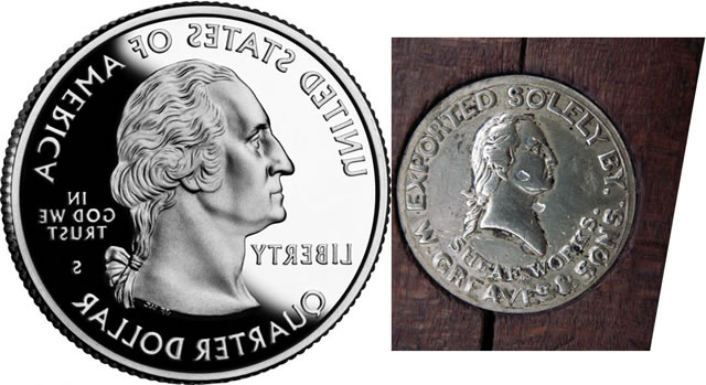

    Not a great deal to add, except to confirm Simon's suspicions that the medallion does indeed look like George Washington.
    Here is a American Quarter, with George Washington on the obverse..(I had to make it mirror image to compare directly with Fred's medallion)..
    Sure looks like Washington to me.

    It looks like Simon's idea is a runner and it may be a "Revolution Centennial" saw.
    This adds interest to it and possibly explains why I had to pay so much to get it. ( Substantially more than my "normal" bid of GBP 7-87).:)

    As for date, I'm still not discounting the 1876 centennial theory.... seems to fit nicely with the George Washington theme.

  18. fred0325
    Hi Christian,
    Well, what can I say. I am for once lost for words - nearly.
    Fascinating twist to this tale, and they are right. It did come off a saw. And perhaps they knew that it did because they took it off one.
    If the notion of "Revolution Centennial" is right and the age of my saw is right, then this is too late for an ACW (American Civil War) specimen. (But I think that Simon did concede that my saw, at a pinch may be 1860 or later). They unfortunately did not supply any evidence as to why it may be ACW in date except the assertion of the seller, and he may be a bit biased as, from my experience the ascription of ACW to anything bumps its price up.
    But, going by the dates for SS and G and Greaves, it does come within the trime-frames. Bit of wishful thinking here but it is possible.
    Prices here are normally persona non grata, but if this in isolation reaslised the estimate, then you can drop the "non" in this instance.
    So, "Revolution Centennial" versus "American Civil War" - it doen't really get much better. But I will believe it when I see it (or rather when either is proven beyond reasonable doubt).
    Fred.

    I found some more neat stuff:
    1. A mention of the medallion in the "American Journal of Numismatics" published in 1873. Unfortunately it doesn't give a date. The journal comes up in a Google search for "Exported Solely by W. Greaves" (you have to quote the phrase to get the result).
    2. A search for "Rare George Washington Saw" (again, phrase quoted) turns up an auction listing for a W. Greaves and Sons saw. They call it a c. 1790 type. They don't have a picture of the medallion, but I'm assuming it's the same one.
    3. A Greaves and Sons straight razor with a handle and sheath that has a very similar George Washington profile on it. That razor is estimated at 1832 (100 years after his birth). Search for "george washington commemorative straight razor".
    4. A Fredk. Reynolds, Sheffield razor, with similar washington engravings to the Greaves and Sons that is estimated around 1840.
    5. A straight razor forum that talks about a W. Greaves razor marked "The Washington Razor". One comment was that it was a common tactic for Sheffield razor makers to include american memorabilia on their razors to help with marketing to the US (e.g. eagle, washington, US ships and buildings, etc...)
    6. A knife that has "Manufactured by R. Bunting & Sons Sheffield" and "W. Greaves and Sons" markings and comment that Greaves probably exported the knife.

    I found the link to the Journal of Numismatics and the reference on the google search page, but could not find the reference to Greaves in the journal itself. Never mind.
    Ignore the next bit in italics, it is not really worth reading, but I did the research and so I thought that I would put it in.
    The only other name that I looked for because I thought that it may help was Bunting as it is not a hard name to search for. That is not a lot of help either as it does not really narrow down the dates.
    The first reference (in the online Directories) that I can find (not necessarily that exists) is Baines 1822 Page 308 where R Bunting is listed as a pen and pocket knife manufacturer. R Bunting only as a company goes up to Slaters 1847 Page 13 where he is listed at 10 regent Street.
    In Whites 1852 (page 76) is at the same place but is now R Bunting and Son.
    He stays this way until Whites 1862 (page64) when there is a Bunting - Henry of R Bunting and Sons and so I am assuming that Henry is a son. This is at 78 Milton Street.
    references then get a bit sparse as there are no directories between 1862 and 1879, where there is no reference to him.
    So all this means is that the reference to Bunting cannot be before 1852 and later than 1879. But as this covers most of the timescale that is of real interest, it is of no real use.
    There is an intersting comment in your post re 1832 being Washington's centenary and about putting iconic American images on products to help with the marketing. I think that Ray made this point quite early on. Even i think that the centenary is a little early for my saw
    The image below is from one of your links or a related link from MJDTools (an auction held towards the end of last year), and this saw is titled a "rare George Washington saw". So I assume that the medallion on it is the same as our. But this is a saw and a half!!!
    Anyway I don't know if we are much further forward, but it has ceratinly filled in an otherwise quiet evening.
