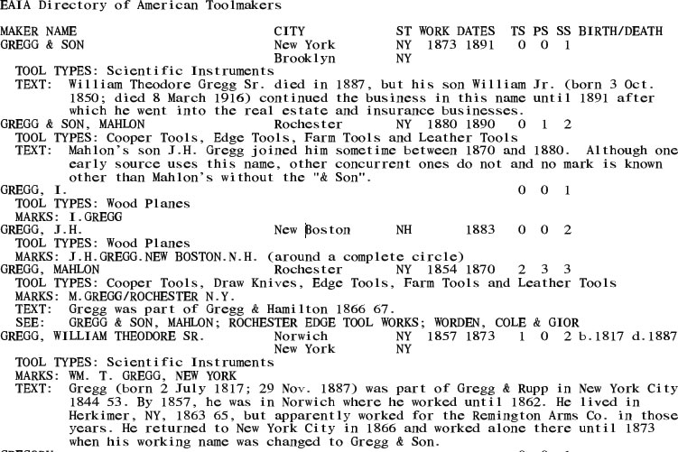

    On a whim, I thought to check the EAIA directory, and there are several Gregg's which made other tools, no sawmakers unfortunately, so there is nothing definitive, but might be worth casting the net across the Atlantic.

    Fascinating about the American Greggs. Although my saw is almost certainly British, I wonder whether the two are related. After all, Kiwi kicked this bit off by his reference to Greggs as planemakers, and you have a couple on your list.
