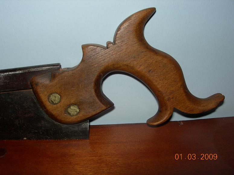

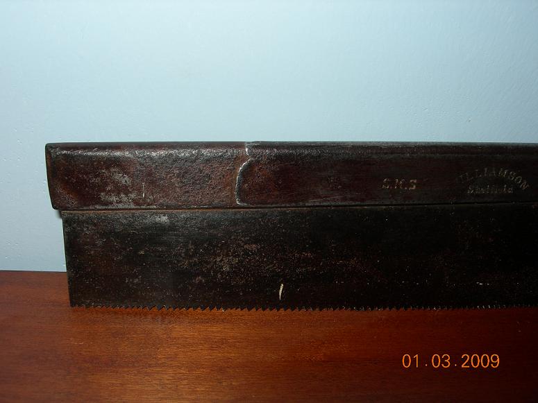

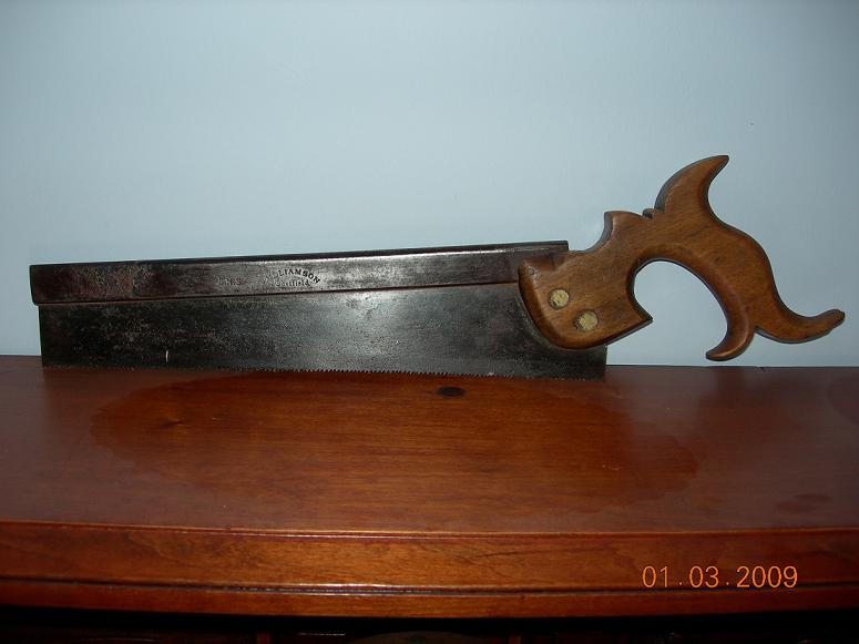

    I promised another saw last post which is a mystery to me.It is unusual not only that I haven\'t any info on the maker (and I am hoping you might help out here Ray)but also on the quality of the saw or the lack thereof.

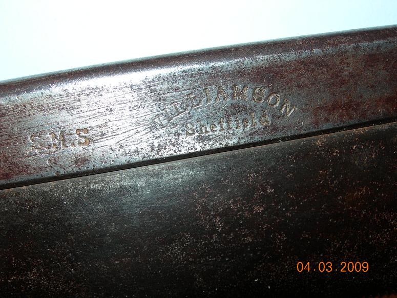

    This 12\" \"steel\" back is marked on the spine with a semi-circle Williamson over a Sheffield mark flanked on either side by S.M.S (owner\'s Initials?) and German Steel. The open handle sports two early slot nuts. It has been cleaned by a previous owner some time ago and is beginning to get some of its age back. The tapered blade measures out from an 1-1/4\" toe to a 2-1/4\" heel.

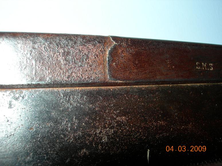

    The most unusual part is the very distinct separating steel spine that would have been manufactured as such. The two pieces look like they were supposed to have been joined but never melded. Williamson would have received the plate, bent it and didn\'t worry if the aesthetics mattered, only that it was functionally acceptable. I wouldn\'t want to try and bend the steel to straighten the blade because it would surely separate even more and really compromise the blade. I don\'t know if anyone else has seen this sort of \"waste not, want not\" get it out the door, type of production in what would have been expensive materials at that time.

    I have a feeling this one might be a bit problematic to track down, from what I can see, Williamson is not a known sawmaker, which sometimes means it could be a merchant\'s brand or a secondary line for another maker.
    I am leaning towards the \"secondary line\" option a little because of the join in the spine, if that\'s the case, then the name is probably not going to appear in the trade directories. Further complicating the search is that Williamson is a VERY common name and any search returns thousands of results.

    The \"SMS\" stamp and the font style used for \"Sheffield\" might provide clues.

    Thanks for the info so far. I would agree that it is probably a secondary saw for one of the company\'s and it really has the \"feel\" of a pre 20th century saw. I do wonder though if as a manufacturer you would deliberately go out and produce a substandard quality saw with the intention of selling it and or what company would accept such a product and still yet produce it with a Sheffield, German Steel designation. Maybe I am seeing this with a 21st century eye who feels that time is too precious to waste with lesser quality because the split is too obvious to hide. A split steel spine couldn\'t be all that acceptable even back then as a second, could it? We have all seen \"product\" marked as second\'s and I wonder if the manufacturers figured this was a way of suggesting that if there is a \"name\" on the saw it has some quality associated with it. This can\'t be the only Williamson saw kicking around and it would be interesting to see if there are more examples.
