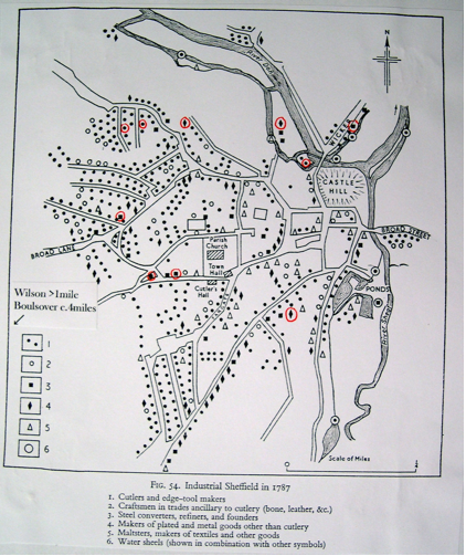

    I have a map which is much more informative than the description I gave of the Sykes/Kenyon early premises, but I can't see how to show it here in a reasonably legible size - I've sent to Ray with a wimp-ish request to see if he can do the necessary.
    When (I'm sure he can) it comes up, you will see a red circle round certain of the work places - these are the pre-1800 saw makers, with Sykes and Kenyon just south of the Wicker, the Isle a little to the W of them, and the Pye Bank address is about on the letter N of the diagrammatic compass.
    Hi Simon,
    Here is the map.. I could post a higher resolution image, if you have one?
    In the 1889 reprint of Gales & Martin 1787 Directory, there is a
    Samuel Sykes cutler Hollis Croft, ( Williams Father )
    which is where John Harrison and Son (saw makers) Hollis Croft were..
    I wonder if there is a connection between William Sykes and John Harrison?

  9. Barleys
    Sykes/Spring
    thanks a lot, Ray - I knew you could!
    And no, it's the only image I have.
    How to tie together these Sheffielders is so difficult: as you can see from the map, the place was so small, and everyone was crammed in to this space, so that everyone must have known everyone else, certainly by sight and reputation.
