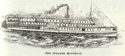

    Could it be "MONTREAL"?

    I think you're right Houblon,
    and it makes sense finding this saw in Canada. I've found some data on a sidewheel steamboat named
    "Montreal", built in 1830 ("Landmarks of Toronto", J Ross Robertson, 1896).
    In 1875 a great change was effected though, for the Canadian Navigation Company in that year amalgamated with the Richelieu Navigation Company, of Montreal, and under the style of the Richelieu and Ontario Navigation Company have continued their business ever since.
    Two steamers ply daily on the river between Montreal and Quebec belonging to R. and O. They are most appropriately named the Montreal and Quebec, and are commanded by Captains L. H. Roy and Robert Nelson. They are "furnished with all the latest modern improvements, are unsurpassed for speed, comfort and safety," and form the only direct daily water route between Montreal and Quebec.
    Captain Roy's steamer is the smallest of the two, but she is nevertheless a magnificent vessel. She was built in 1830, as so many more steamers have been, by Gilbert, of Montreal, is of five hundred and nineteen tons capacity and can comfortably accommodate nearly two hundred cabin passengers. She had new boilers in 1891 and is lighted throughout by electricity. She is a sidewheel iron steamer with compound engines.
    The above picture shows a ship essentially the same as on the saw etch, except there is less overhead masts and guy wires (but modifications during the ship's lifetime may account for that) [picture below shows rigging more like the saw etch ]
    I think this indicates my saw was probably made specifically for the Canadian market, and likely by an English manufacturer as no Canadian sawmakers I'm aware of used this style of etching.
