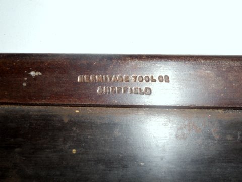

    It's a fairly sad example, but it's a taylor brothers handle style that I particularily like. I'm going to restore it into what I hope will be a good user.
    The Steel back is marked Hermitage Tool Co. Sheffield

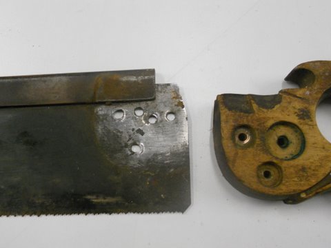

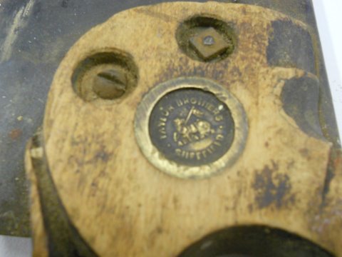

    And the handle has a Taylor Brothers Medallion, in addition to some "custom" handle fixing. Probably not patented.
    My first thought was that it's another one of the many Taylor Brother's brands.
    But on removing the handle its starting to look more like a "Frankensaw" the handle is definately not original to the blade,
    So it could well be a Robert Marples? with a replacement Taylor Brothers handle.

    Thanks a lot, Ray. It really does seem to be in part a Robert Marples saw, with a good deal of what might be called attention subsequently, including mucked-about screws. I've seen a lot of saws with this kind of distinctly mixed parentage.
