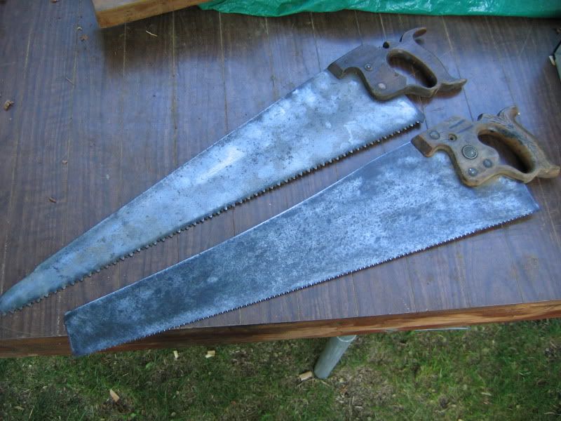

    I picked this saw up a while ago and asked at the time if anyone had any information regarding the stamped name in the saw. There was one reply that had some information but the forum it was on no longer has the thread and I wasn't smart enough to save it locally. Any information or help is appreciated.
    If I remember correctly one of the names was thought to be Rutherford. There was also some discussion with regards to the handle being original.

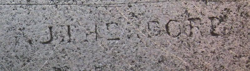

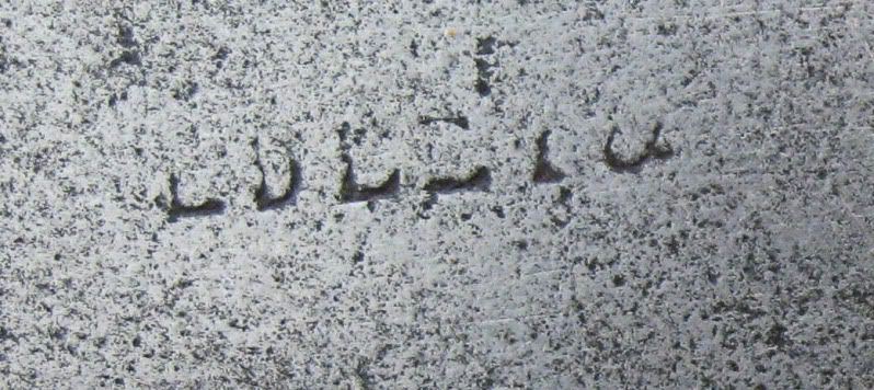

    I see "something" Rutherford, over "something", over GE-------EL (GERMAN STEEL), with three crowns.
    Which only gives you "Rutherford" to look for. I found this...
    Rutherford, John (, saw, busk, scythe, trowel &c. manufacturer).
    Residing at 53 Arundel Street, in 1833.
    Recorded in: Whites History & Directory of Sheffield - 1833.
    Rutherford, John (, Saw mfr).
    Residing at 53 Arundel Street, in 1837.
    Recorded in: Whites Directory of Sheffield & Rotherham - 1837.
    Toby

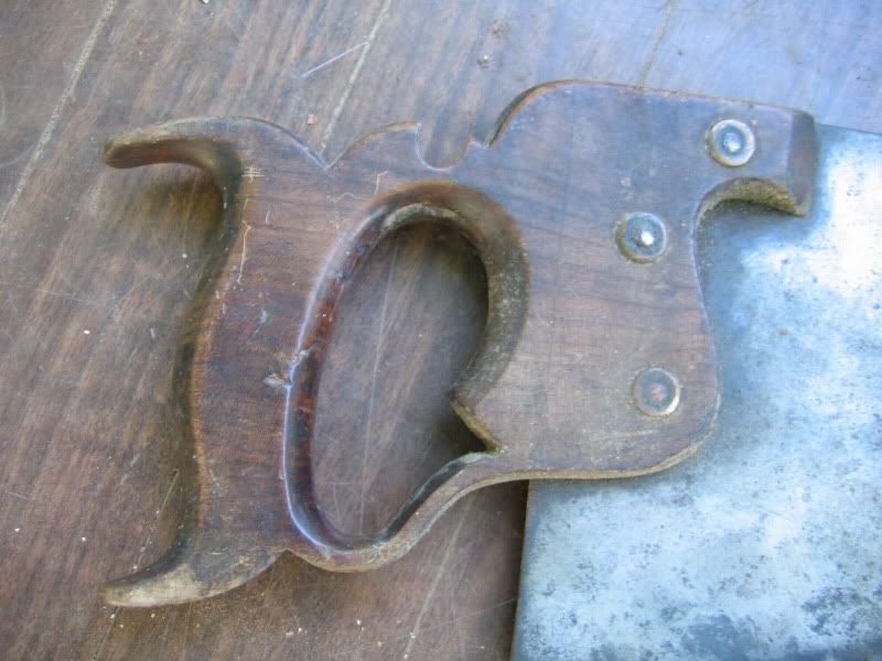

    Interesting saw, I'm a bit intrigued by the handle, the things that stand out,
    1. Doesn't look like an 1830's handle, ( very subjective observation I know)
    2. The handle appears to be poorly fitted, off center slot and angled...

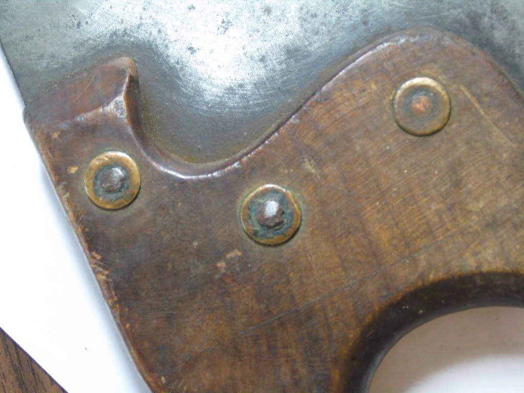

    3. The handle fixing, looks like nails that have been hammered over as rivets.
    At a guess I'd say that the handle was replaced by a user many years ago, maybe even as much as 100 years ago or more
    So, just speculating, the saw plate is probably 180+ years old, and some one during that time, valued the saw sufficiently to buy a replacement handle** and fit it to the saw. A stark contrast to today's throwaway society.. :)
    I'm probably completely wrong, but speculating can be fun.
    ** most manufacturers offered replacement handle blanks, undrilled, and probably not slotted, it would be interesting to try and identify the make of the replacement handle, might help date the repair.

    216
    I was thinking the same thing about the handle, but I have no experience with riveted handles.
    The rivets and washers don't match each other, and one washer was apparently never installed.
    And I'd say that the handle doesn't show as much age as the blade.
    I would also agree that they probably bought a replacement handle that was undrilled and unslotted, the handle is well made, but not installed very well.

    Makers mark looks to be EDLEY & RUTHERFORD
    ( I don't know why there is such a large gap between Edley and Rutherford, maybe they were already estranged, as they seem to have operated their own separate businesses after 1829 )
    HSMOB lists Edley & Rutherford as being located at "Bottom of Arundel Street", 1825-1829

    Thank you for all the replies. I agree that the handle is most likely a replacement. The big thing I noticed was how poorly it was fit to the saw. Early 1800's, that's really cool. The saw is pretty used up, this one may just end up on the wall.

    Ryan

    Then reading this post I thought that the handles seem pretty close at first glance ...

    I too was thinking Disston, and if you look through some of their catalogs you will see that they did sell handles, both drilled and undrilled, so it is possible. However, many, if not most saw companies, at least in the US, sold replacement handles, and quite a few looked very similar, so it will be difficult to positively identify on looks alone.
