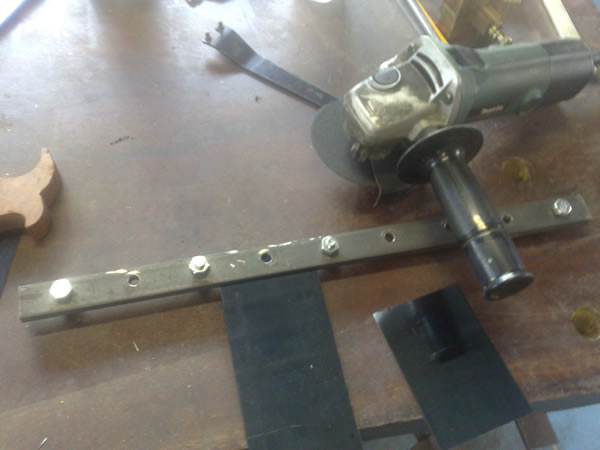

Hi Regis, There are many ways to cut saw plate, this is what I have come up with, I sandwich the saw plate between two pieces of flat steel and run an angle grinder with a 1mm cut off wheel along the line. The steel acts as a guide for the cut, and also acts as a heatsink so that the blade temper is not affected. Another way of doing it is to score the line with a carbide tipped scribe and clamp the plate in a smooth jawed vise and just snap it off, the problem with this method is you need a good smooth jawed vise and the bit not clamped in the vise is distorted after snapping off. Whatever method you use, you still need to clean up the cut with a jointing file. ( a file clamped in a guide ) Regards Ray
