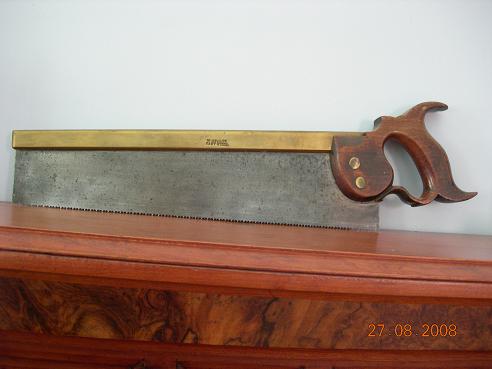

    It is interesting to conjecture what happens in business relationships and the subsequent changes as time goes on. We know that William Staley joined Kirjarth Maw(what a great name) to create Maw and Staley in about 1825 who made all kinds of edge tools. I have examples of these tools in blades, mortice chisels, and plough irons. I am interested in seeing an example of a saw with the two names on it, if there is such a thing. I have pictured here an example of a saw with just William Staley\'s name on it. Did Maw die in 1833 when William became the sole owner and are there examples of his other tools with only his name. It was later bought out in 1839 by Fenton and Marsden as per Roberts.
    This is a closed beech handled brass back 14\" saw. The front tapers from 2\" to 3\" at the at the handle. W.Staley, Cast Steel was stamped in the into the brass back. The handle is held on by two 7/16 slotted brass screws. There is so very little pitting on the back of this blade, I would call it surprisingly clean and it was unfortunately cleaned earlier in its history. It still has some black finish in the handle.

    Thanks for showing us a beautiful saw. Here are some initial notes.

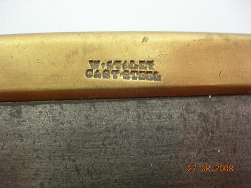

    I notice a \"dot\" in the CAST.STEEL I have been keeping an eye out for this,
    According to Simon Barley, this is seen generally before 1830 and rarely seen
    after.
    Can you take a close look at the mark and see if you can tell whether it\'s part
    of the original stamp?

    The handle style is Dolphin, generally a later style than London, only 2 screws, generally less screws indicates earlier
    rounded back chamfer (the chamfer at the bottom of the brass back) more rounded earlier.
    I haven\'t looked at Roberts yet, I will do that over the next few days.
    Wow, Joe what a great saw, and condition is excellent.

    It was a good observation on the dot between the cast and steel because it is identical to the mark between the W and Staley. Does this mean we can push the C. 1830 for dots back a little or say that the stamp was made and needed no further changes if there were some made almost to the 40\'s? The suggestion got me looking through more of the collection.... and what do you know, some more examples. We can bring some of these out as we go farther along.
