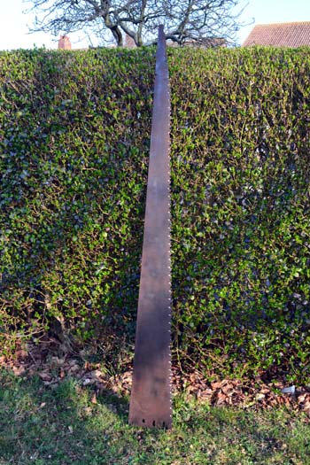

    anyway sorry for the delay, I have tried to attache a photo of the saw, and couldn't quite work out how to do it, so will send it to Lui. They are rather hard to take a meaningfull picture of, as this one is 2m long. (I was intrigued that it came out to a metric measurement - was expecting an imperial one).
    Unfortunately Lui wasn't quite right about one thing: I in fact have never managed to use this saw, as it is impossible to set the teeth. it seems to go in patches - small sections of teeth are so soft that they set far too easilly and I can't believe that they will keep the set, but most of the teeth are just so hard that I either didn't manage to set them at all, or they break off! haveing lost 3 teeth in this fashion, I'm not keen to loose any more, so was wondering what I can do about this? I asume it is the natural crystalisation of old steel - but I don't really understand the process: is there anyway I can rejuvinate it?

    Barbara emailed me this picture of the saw..
    Now there's an impressive saw!.. I'm not sure I'd like to be the man on the bottom of the pit with a saw like that. :)
    I wonder if it might not be from one of those machine operated gang saws?
    Nice detective work Fred, (you are getting pretty good at this stuff ) I'll see if I can get that directory information and add it to the thread.

    Thanks for the picture of the saw although I think that it asks more questions than it answers.
    Unfortunately Barbara, my ignorance of processes involving steel is matched only by my ignorance of saws, although I hope that some who use the site will have some idea of those selfsame processes. I did notice on the close-up that Lui posted that there was a fair bit of deep-ish pitting to the teeth. This must affect the way that they take a set, but I am not sure how it (weathering) affects hardness, if it does. Although I do remember someone saying on a previous topic that cleaning/treating saws with acid was not a good idea as affected the hardness of the steel, making it (I think) more brittle.
    Now, dredging my mind back 45 years to school, oxidation by weathering will be a related process to generic "oxidation" by acids (look up REDOX reactions on Wiki). So will prolonged weathering make the steel more brittle and mean therefore more snapped teeth???:confused:
    Also is it a two (politically correct):) person saw? I have only seen pictures of pit saws and they have always been two man ones, but the taper on the narrow end seems to me to leave little room for a handle to be mounted in comparison to the triple mounting holes at the other end.
    I have never heard before of one of Ray's gang saws but it does look as though serious force could be applied to it only through the wider end and that may well imply mechanical as opposed to human force on a saw of this size.

    I'm not a metalurgist, but heating the saw and adjusting the saw hardness without upsetting the saw tensioning might be tricky.
    I've noticed on some of my harder steel "Vanadium steel" handsaws, that the manufacturer recommends setting the teeth by hammer setting only and not by plier setting, which I presume is to reduce the chance of breaking teeth, (However, I'm not sure what method you've tried, nor if this advice is applicable for your saw).
    The end taper on the blade looks a little unusual for regular pit saws, but there seems to be enough space for a typical pitsaw lower handle (the "box"), which consisted of a wooden double handle with a slot to fit over the blade and a wedge to lock it in place [you need to be able to adjust the location of the handle along the blade to suit the depth of the pit and the height of the sawyers]
