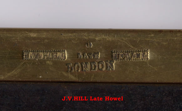

Hi Fred, Lui, Congratulations Fred, that's a beautiful looking saw, as Crocodile Dundee would have said ... "Now that's a saw" You have to admire the workers who could rip timber with those big rip saw like that all day long... I remember looking up JV Hill late Howel, in HSMOB, and never thought to chase him any further. I didn't expect he would be hard to find... However it took longer than I thought, I eventually went through all the Hill's one by one in the 1841 London Post Office Commercial Directory And at last found him... Joseph Vaughan Hill, Saw Manufacturer (Maker) I will see what other years he turns up in... and see if we can get a better idea of the operating dates. There is a Hill late Howel backsaw floating around here somewhere, but I can't see it at present. Ok, Here is the mark from that backsaw.. As for date, on your saw, I would think very likely to be pre 1850, just going by the style. Maybe 1830's? Regards Ray Edit: Any Ideas, as to what the "who." abbreviation means, I suspect it might be "wholesaler" I also there is notice a JV Hill folding rule listed here.. http://www.thebestthings.com/measurin.htm
Hill late Howel Lovely saw, indeed, Fred. You have some very discerning Christmas gifters. Here is what I have been able to find out about this man. HILL, Joseph Vaughan LONDON 64 Cromer Street, Gray’s Inn Road [also given as Judd Street] 1834-1836 5 Chichester Place, Gray’s Inn Road 1839-1863 252 Gray’s Inn Road 1864-1909 Saw maker and tool dealer, but also produced many planes marked J.V.Hill; a letter head from his early days describes him as a wholesale saw manufacturer. He was foreman to J.Howell (Howell’s own invariable spelling), planemaker of Chelsea (1806-1840), hence the marks. His use of a zigzag bordered mark is exceptionally late; his marks on saw backs are invariably more deeply struck than almost any other maker’s. Recent research by Jeff Warner has shown that his prosperity (considerable: he died a rich man) was based on his business being close to the piano-making area of London, The longevity of the firm was due to its continuance under the same name for several years after Hill’s death. I think it's unlikely that his saw is as early as 1830; the 3-screw (note the top one - slightly smaller than the other two), narrow-ish nose was the frequent pattern for hand saws from London makers (and "makers" ie those who had them made with their name struck - perhaps JVHill was the wholesaler who supplied them - he was certainly a true saw maker, although I suspect he bought his saw plate, maybe ready rolled, from a Sheffield supplier) - for the period 1860-1880. I have a couple of H late H handsaws with a mark almost identical to Fred's which I have dated (tentatively) at c1880-1890 - but as with nearly all dating, I could well be wrong. A possible clue to lateness is its being a 28inch rip; by that time machine sawing was becoming much more common, and although the hand saws were still being made, and bought, I suspect that the days of many hours of ripping by hand were coming to an end - hence a saw in comparatively good shape - although as Fred says, it's got finger wear, which is always an awesome sign of hard graft. Greetings to all for 2011 Simon
