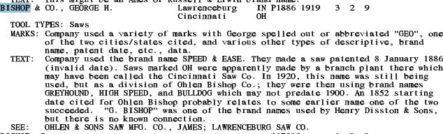

    The EAIA directory mentions that Henry Disston used the brand "G Bishop", but goes on to say that there is no known connection with the "George Bishop" we are referring to? I wonder if the EAIA directory is confusing "C" with "G"
    Here is the EAIA directory entry
    Just speculating....
    It may even have been a marketting ploy by Disston to create a little confusion by offering "C Bishop" in competition with "G Bishop"
