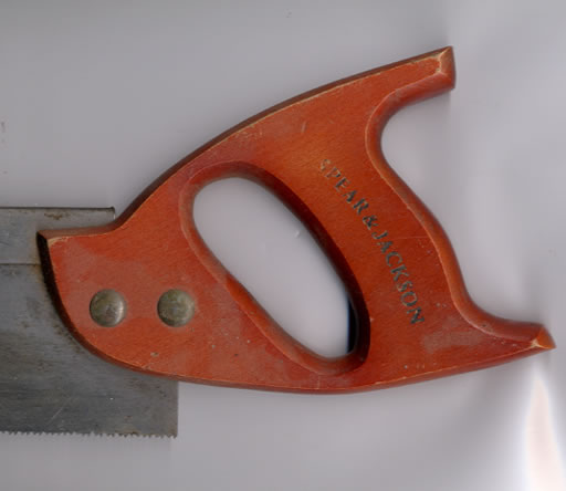

    Here is a 100 years (or so) of Spear and Jackson handle styles. 1900-2000 (give or take)

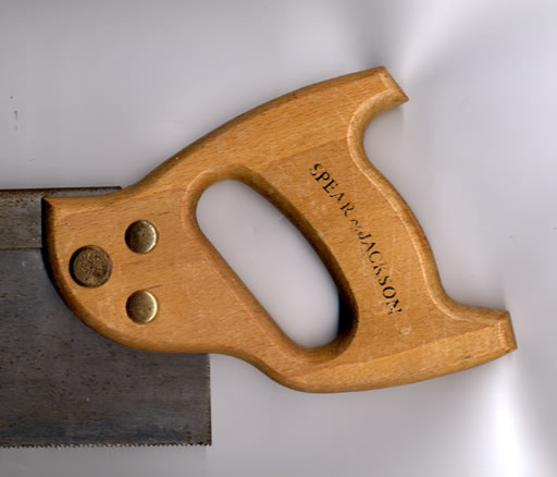

    1. Starting with a Number 26.
    2. And another Number 26, but notice the lamb's tongue has gone.

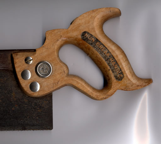

    3. This one is a Leapfrog Number 46, probably 1920's, note the extra screw
    which is claimed to stop the back from slipping... and a dowell vertically
    through the handle, hence the "unbreakable claim"

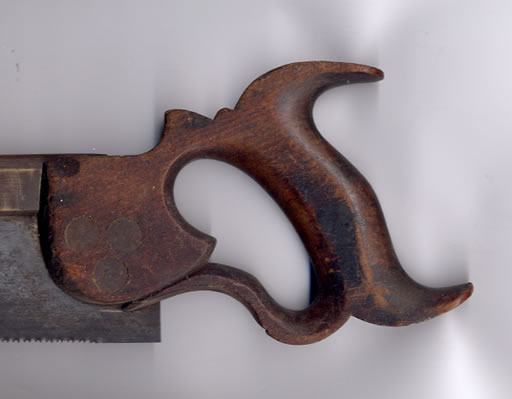

    4. All stamped marks on the back have now gone, and a cheap plastic washer has replaced the medallion.
    5. By now, the screws are non-removable rivets, and the handle become a little more streamlined...

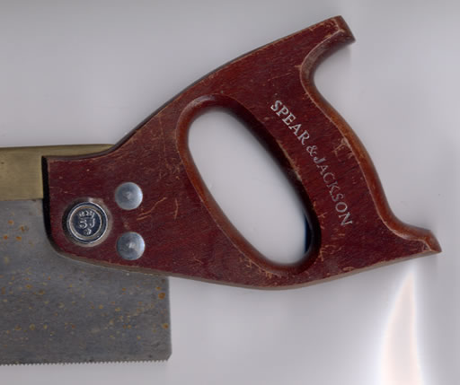

    6. This one is possibly a premium model, as it features a brass back and larger plated medallion.

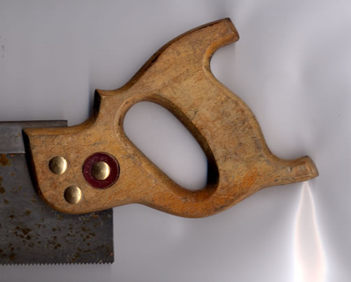

    7. The "Cockerill" name from earlier times is retained, screws are non-removable, no medallion, no printing on the plate either.

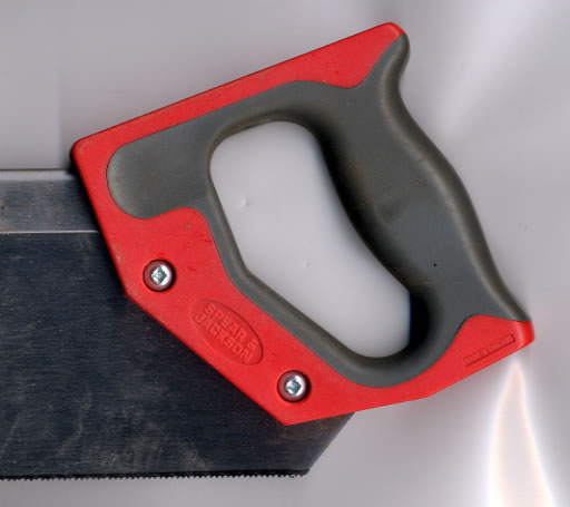

    8. Finally, the current model (well it was, a year or so back)
    Plastic handle 4 finger grip, hardpoint, induction hardened teeth which
    are non-sharpenable. This is a disposable product.
    In spite of all that it actually cuts nicely.
    When taken as a whole, there is clear evidence of gradual evolution of the style.
    I think it's possible to compare two saws and make a reasonable estimate of which one is earlier...
    I would like to see more Spear and Jackson backsaws, so as to try and construct some sort of timeline.

    Hi Fred, Kiwi,
    Spear and Jackson, used a number of marks on secondary lines, LLoyd Davies, Cockerill, and (I believe) John Spear, although, I suspect John Spear may have been a premium product line. At times, in the second half of the 19th century competition was pretty fierce, and I suspect therein lies the motivation for many of the secondary product lines, just like today, it's all about getting a share of the market.
    Adding those two (thanks kiwi) into the time line, and adding some initial dates, also making the images a bit more manageable in size we get..

    Ray, here is an intermediate step between 4. and 5. in your latest list.
    This is a 14" backsaw and only has 3 screws, compared to the 4 of number 5. and the hang is similar to Number 4. You will probably get a lot of handles. What about catalogues? Will dig through mine to see what I can find.
    And what about open handles?
    Hi Peter,
    Thanks for that, I will edit the post to insert that one into the timeline.
    I've been thinking that catalogue entries will provide valuable timeline data, what S&J catalogues do you have?
    One thing that catalogue entries will resolve, is the difference between the various models, some of the lower cost secondary lines, have less refinements and features that sometimes look like later models. I'm thinking of the "Goblin" that is in the 1915 catalogue, which looks a bit like the premium lines from 20 years later...:)
    Regarding open handles, yes I think so, (but I don't have any), the only reason I chose S&J for this exercise is that there are enough of them around (hopefully) to make it possible to trace the detail of the design changes.

    This thread is very interesting as I'm always trying to identify and determine the age of my saws, but I took a look at my 1915 Spear & Jackson catalogue reprint (the only S & J catalogue I've got) and it seems that there might be more variation in handle design between different saw models of the same year than between saws of different years.
    The 1915 catalogue for closed handle backsaws shows (sorry, I don't have a scanner handy to illustrate this)
    BEST QUALITY saw handles are finely carved with; “lambs-tongue†bottom edge, a small “nib†between the peak and the horn on the top, and a “fishtail†heel below the grip (sorry Simon; thats a “crooked†handle with a “one-peak-one-nib†top)
    SECOND QUALITY saw handles lose the lambs-tongue, but are otherwise unchanged
    THIRD QUALITY saw handles lose the little nib on the top
    FOURTH QUALITY saw handles lose the vee in the handhole, leaving a plain ovoid hole for the fingers, and also the “fishtail†heel is less finely detailed.
    FIFTH QUALITY saw handles lose the fishtail and have a plain flat “London pattern†base
    And just to make it more difficult, some owners (not naming any names ) re-carve or replace some of their handles to suit their personal preference of fit and style.
    All this makes it difficult to age a saw with any degree of accuracy, based solely on its shape (same applies to women I guess), but its fun to hold them and check out their hardware and guess their quality line and age !
    Regarding the saw hardware; the first quality saws have “raised brass screwsâ€, and all lower class saws have the cheaper “flat brass screws†or split-nuts (sorry Simon, “spanner nutsâ€) So we can probably say an S&J lambs-tongue with split-nuts is pre 1915, non lambs-tongue with raised brass screws and saws with steel screws are post 1915
    You can get either steel or brass backs on all quality lines, except fifth quality which only comes with a steel back. So thats not much help

    Got this 12" Spear & Jackson backsaw at a sale this week. It has the hook in the handle that I like and is basically the same handle shape as the 14" 1866-1875 saw I posted earlier in this thread, similar spine stamp too. (no etch).
    But with its crisp lines and nicely blued steel back, this new-to-me saw doesn't look nearly as old as the other one, more like turn of the century (maybe 1890s) to me. The grinding lines on the screws and nuts are all aligned, so I don't think this saw has ever been taken apart and "rejuvenated".
    I suppose its possible that I just found a saw that is "hardly used" (rather than my usual "used hard" saws), and the two saws are age cohorts, but the older I get the less sure I'm becoming on getting any great accuracy in guessing a saw's age from its style
    Q; When did blued steel backs first make their appearance ?
