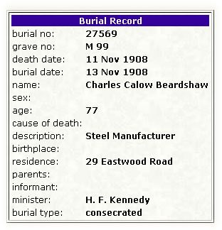

    I know that Kiwi put his Beardshaw (Rosling) saw on for the medallion but I think that the saw itself has turned out to be of equal interest. My saw is not as itrinsically good or probably as interesting as the Rosling, but at least I am able to speculate with fair degree of certainty why Beardshaws attached this brand name to their saw.
    I don't know whether it is Ray or Simon (probably both at one stage or another) who have remarked on the apparent randomness of the attachment of some brand names to saws, but I think that this saw has Charles Calow on the medallion for the simple reason that Charles Calow looks like being the middle names of one of the Beardshaws.
    Now last time that I looked something up in the historical directories, Simon pulled me up ( and quite rightly so) for transposing the christian and surnames of the maker and so I direct you to Whites 1879 Page 405 where you will see:-
    Beardshaw Charles Calow (J. & Son); h 8 Taptonville
    (Also see images {the top entry} below if I can transfer it properly).
    And so could it be that Mr Charles Calow Beardshaw decided to name a brand of saw after himself, however obliquely?
    I wonder if we will ever find a brand/make of saw called Edward Taylor? See second entry down.

    Nice well proportioned saw, and I must say I like your new background. (The old one was good too.)
    Charles Calow Beardshaw would have been an interesting gentleman to talk to, he lived until 1908, having been born in 1831, he would have lived through the hey-day of Sheffield sawmaking. He was 19 at the time of the 1851 census.
