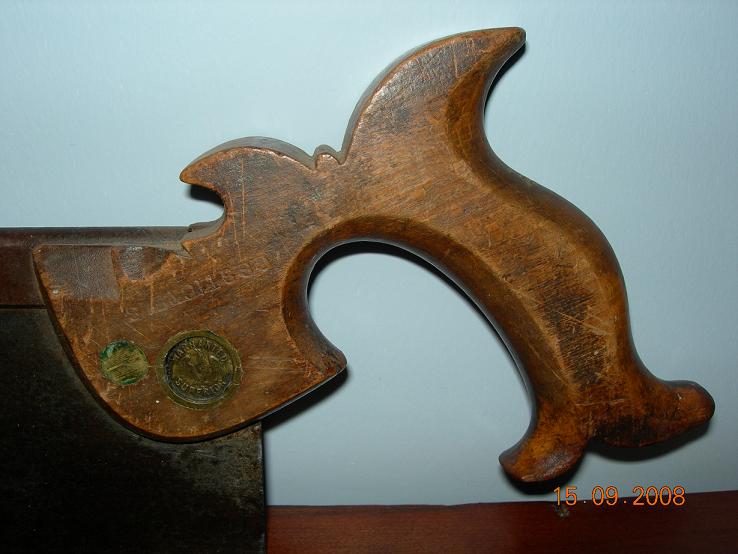

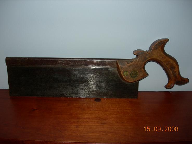

    Hey All,
    Here are a pair of saws that have an A.Rosling mark on both spines. The markings are quite different from each other and I wonder if these were done at different stages in the company\'s history or if they got separate treatment depending on the quality of saw. I haven\'t seen the maker listed but wondered if it was a brand saw from a large merchant. If the \'dot\' between cast and steel follows the 1830 theory they might date from this time but the handles remind me of a mid 19th century saw or later. This combined with the \"warranted superior\" medallion also might suggest a later date. Comments are welcome.

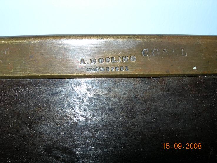

    The first saw is a 10\" brass back, open handled saw marked A.Rosling, Cast.Steel. An original owner also marked it C.Gall. There is 1\'3/4 depth to the blade. The beech handle is held in by two split brass nuts with the larger marked Warranted Superior. An eagle or something to that effect since isn\'t all that clear or well impressed centres the medallion. The nuts measure 7/16th\" and the medallion 3/4\"

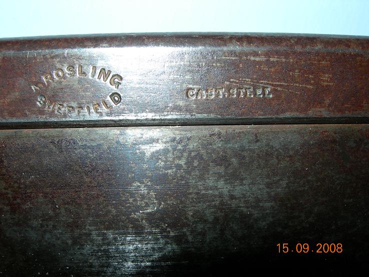

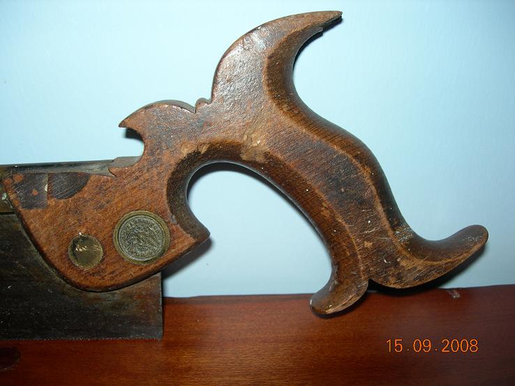

    The second saw is an open handled 12\"steel back, also marked A Rosling in a semi circle above a semi circled Sheffield. Cast.Steel is to right of the previous lettering.The blade tops out at 2 7/8\". The beech handle is held on by one brass split nut and a replaced Warranted Superior medallion and a later domed nut. This eagle is well defined.The once proud owner C S Stickels marked the handle twice.
    Both handles have almost identical double chamfers, chamfer stops, beaks and top nibs. The cheek curves are identical. The major difference is the robust size of the larger saw handle and the significantly rounded horns. The brass back saw handle is almost sharp by comparison to the larger back saw but it is unknown if this was adjusted this way through use.
