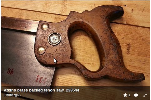

    Hello
    Let me start by introducing myself. My name is Kim and I live in Finland. I have a tool addiction but I also suffer from an over optimistic disease which means that I buy tools on the web without doing my research first. The end result is that some of the tools I acquire are not what I thought they would be.
    My most recent example came in the shape of a 14 inch tenon saw with a unmarked brass back, a later era handle fitted to the plate and spine with three E.C. Atkins nuts made of brass.
    The handle has three holes but the plate has four round holes and a rectangular one. The plate feels older than the handle but I could be wrong again.
    What I cannot understand is that the plate shows no trace of being fitted with another handle. Also, if the handle was replaced it is odd that two of the existing holes matched the handle perfectly. With my limited experience this has seldom been the case.
    I also feel that the saw plate and brass back are older than the handle. But I could be wrong - again.
    I have exhausted sources at ukworkshop and sawmillcreek and no one seems to make sense of this saw so I'm hoping someone here might be able to help.
    I know this saw could have been put together using parts from several saws. But the only way to find out would be to identify the handle. If the handle can be matched with a maker, then it can be compared with a saw by that maker and then I'd know for sure.

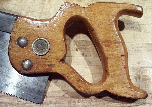

    The handle doesn't look like an EC Atkins, my overall impression is that it's very much like a Disston No 5, with an Atkins Medallion? and a Disston No 4 handle....
    Very interesting.
    Here's a late model Disston No 4 Handle
    And here is the mystery saw.
    While not identical, there are enough similarities to warrant further investigation.

    I have good news. I have been corresponding with Michael Merlo, a renowned saw restorer in the US and one of the few people I know who actually knows a bit more about the Atkins saws.. He tells me he owns a saw like mine and that my saw is a Atkins saw. Yesterday I also got a message from a English woodworker who told me he owns another Atkins saw with a similar appearance. I am hoping to receive a picture of his saw for comparison.
    The English gentleman also told me that the backs on these Atkins saws are chamfered to fit the saw plate into a recess in the back. I'm not sure of other makers doing such a thing, but it certainly explains why the back of my saw was dead straight in alignment with the saw plate.
