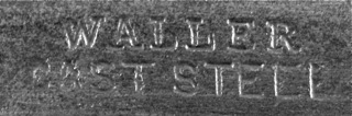

    In another life I am a stamp collector and also an engineer. One of the sad things we do with early stamps is look for minute differences caused by wear to the metal plates, so you can tell if the plate used was new, worn and even repaired. This helps me distinguish between dates of printing for the stamps and appeals to my engineering eye for detail.
    Clearly there are 5 different Waller die punches being used, I am not sure if my saw relates to any of these, so maybe 6.
    The first punch mark shows the end of the W missing. There are very slight irregularities of the level of the letters or in letter spacing. It may be necessay to measure the length on the name very accurately.
    My point is that with more detailed observation of the stampings it may be possible to detect how many similar looking punches can actually be identified, it may even be possible to detect wear of the punches. If we find there are many punches used by a not too common maker, then we would know if, as I suspect, punches did not last for very long. This being the case, if one saw could be reasonably accurately dated, then another saw with the same punch mark could be dated to the same time.
    This might help decide if a saw was likely to be stamped with the previous owners name after a take over. Less likely if the original punches had worn out fairly quickly.
    To build up this sort of data it might be necessary to measure the exact length of a name to a millimeter and the height of the letters possibly to half mm. If it was deemed worth while, then perhaps everyone submitting a photo could include these details?

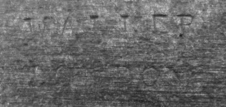

    At last I have found the camera lead so here are pictures of my Waller &Co.
    I cannot get them to load into the forum so they are in my Gallery.
    Afraid the name stamp is fairly light and even careful back lighting has not brought it up well enough.
    It is very close to the stamp used on the 14 inch Grifter, but htere are tiny differences in The left serriff of W is pronouced on the 14" on mine it is not. The center of the A is also stamped on the 14" on mine the centre of the A is clear. The position of the o of Co on the grifter is just lower than the top of the other letters on mine it is exactly level.
    I will either try to get a smoke image or another better picture of mine.
    Graham

  17. ray
    Hi Graham,
    I'll try to insert that image here..
    First impressions are that it looks like an early 19th century, just two screws and London Pattern handle with flat horns (aka london flat)
    But, as we have seen recently similar features appear on lower quality late 19th early 20th century saws. (I'm thinking of the 1917 Taylor Bros that Fred posted).
    I note the screw heads have sunk slightly into the handle, which, according to my (unproven) theory, is an indication that the saw was in use over a number of seasonal cycles of high/low humidity.
    The lack of detail on the lambs tongue, and sharp features in the handle shaping, make me inclined to lean towards thinking it's likely to be the later date.
    It's still in remarkable condition considering it's at least more than 100 years old.
