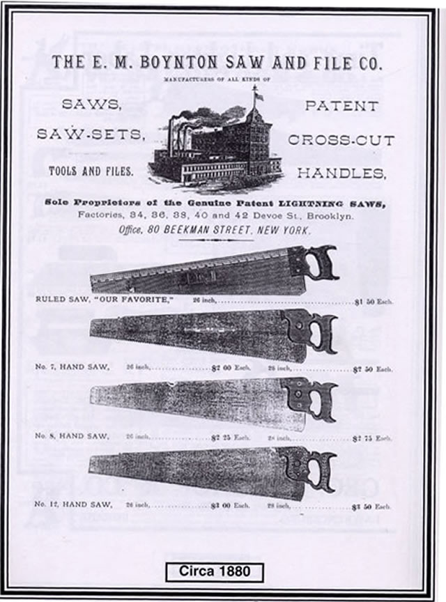

    You will already have seen this Advertisment in HSMONA, but I'll post it here for the benefit of others.
    Image above scanned from "Handsaw Makers of North America" by Erwin L Schaffer [page94]

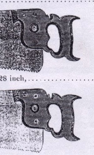

    And a close up of the two handles in the centre.
    The top handle is the Number 7 and underneath it is the Number 8, I think yours is more like the Number 8, just going on the screw hole positions, and the shape of the heel.
    As to the significance of the 40 stamped under the handle, I notice there were multiple factory addresses in Devoe Street Brooklyn, 34,36,38,40,42
    I wonder if the 40 stamp was to identify which factory it was made in?
