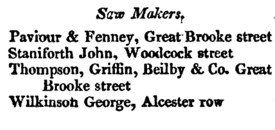

    It looks like you were on the right track, I found Beilby & Co in the Birmingham Section of Baines 1822.. Yorkshire Gazette.
    So I guess the next step would be to expand the search to include Thompson, Griffin, Beilby & Co. ( I haven't done this yet )
    Just from the general look and style ( always likely to be misleading :) ) it looks to my eye about right for early 1800's 1822 would not be too far amiss...

    The successor firm Thompson, Leonard, Dawes filed for bankruptcy in 1838, ( London Gazette ).
    I was hoping to find a partnership dissolution notice in the Gazette, but no such luck.
    Beilby & Co is still mystery... It might not even be related to Thompson, Griffin & Beilby & Co.
    But If I had to guess, I'd say it might be a predecessor firm, since we can track something of the successor firms.
    I found references around that time to, Thomas Beilby and a James Henry Beilby as partners in a couple of businesses in Birmingham, Booksellers and Stationers. not sawmakers.
